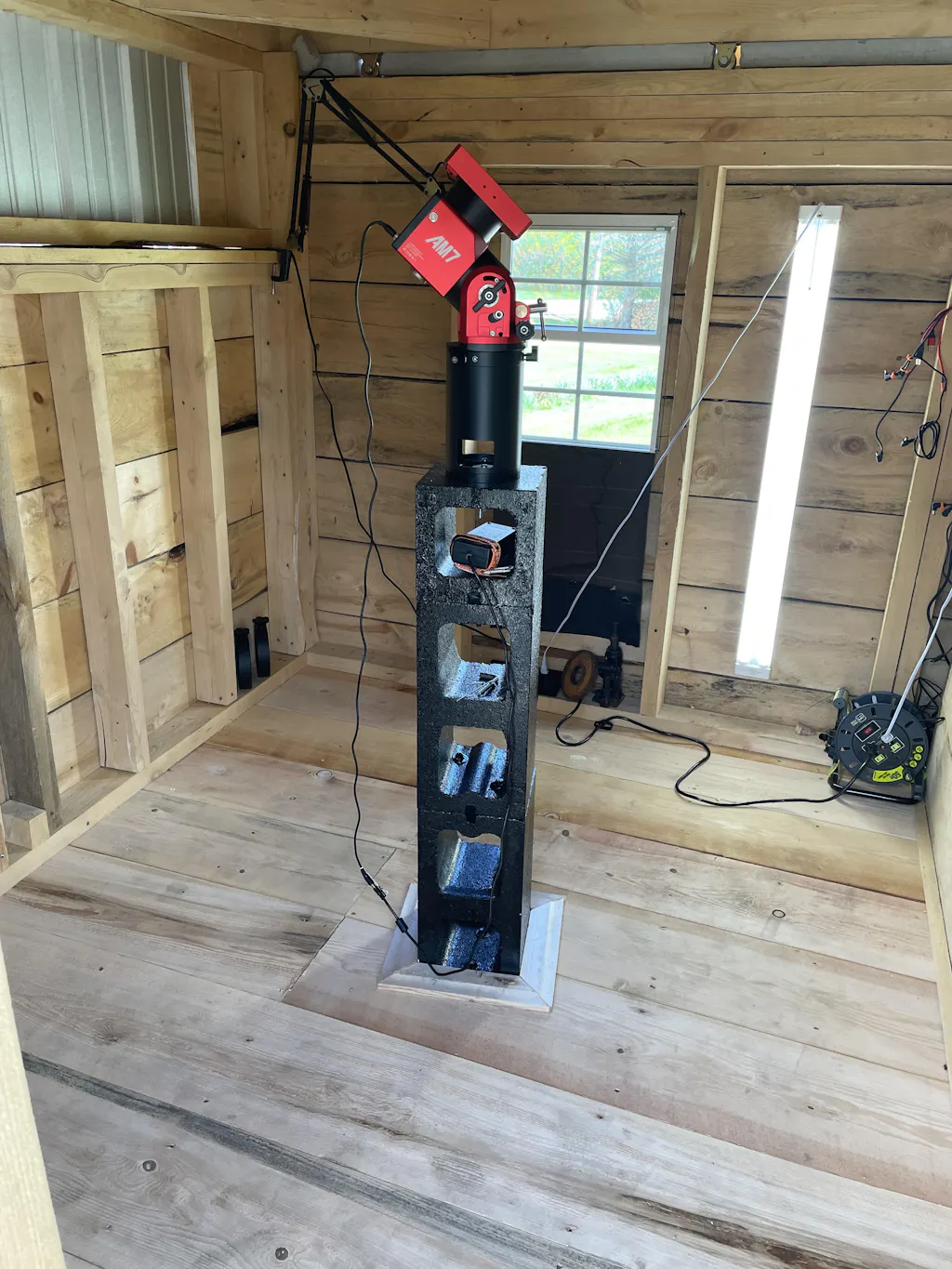

Mark E Weeks
So far very impressive. Best guiding numbers I’ve ever had running my C11 533 mc pro with all the goodies. Blue tooth works flawlessly. I couldn’t be happier.
User picture User picture User picture
