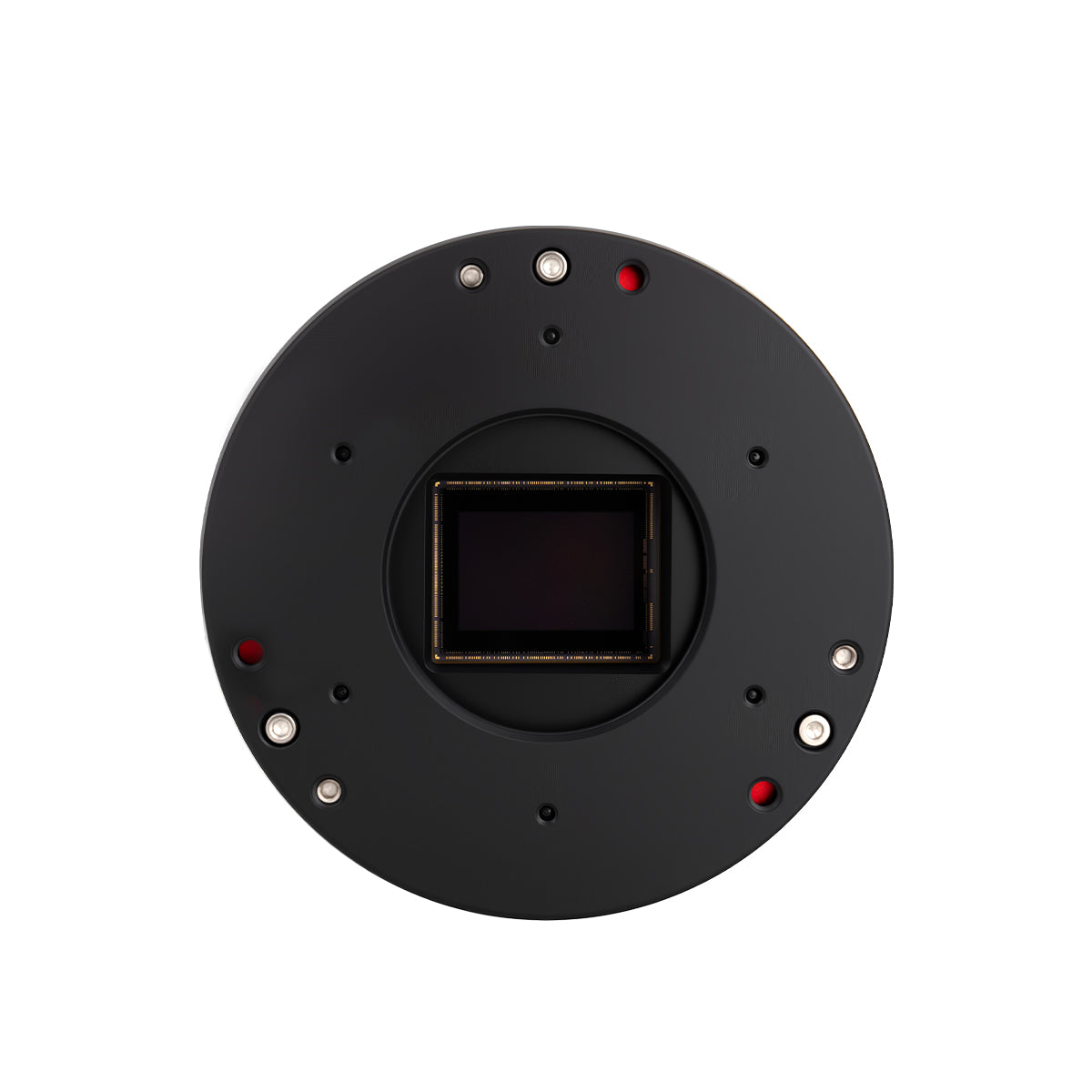

Sensor Tilt Adjustment
The camera incorporates a tilt plate with three sets of adjustment screws. In combination with the three mounting screws, they enable precise fine-tuning of the sensor plane for accurate alignment with the telescope’s optical axis, ensuring a flat imaging field and consistent star shapes across the entire frame.
