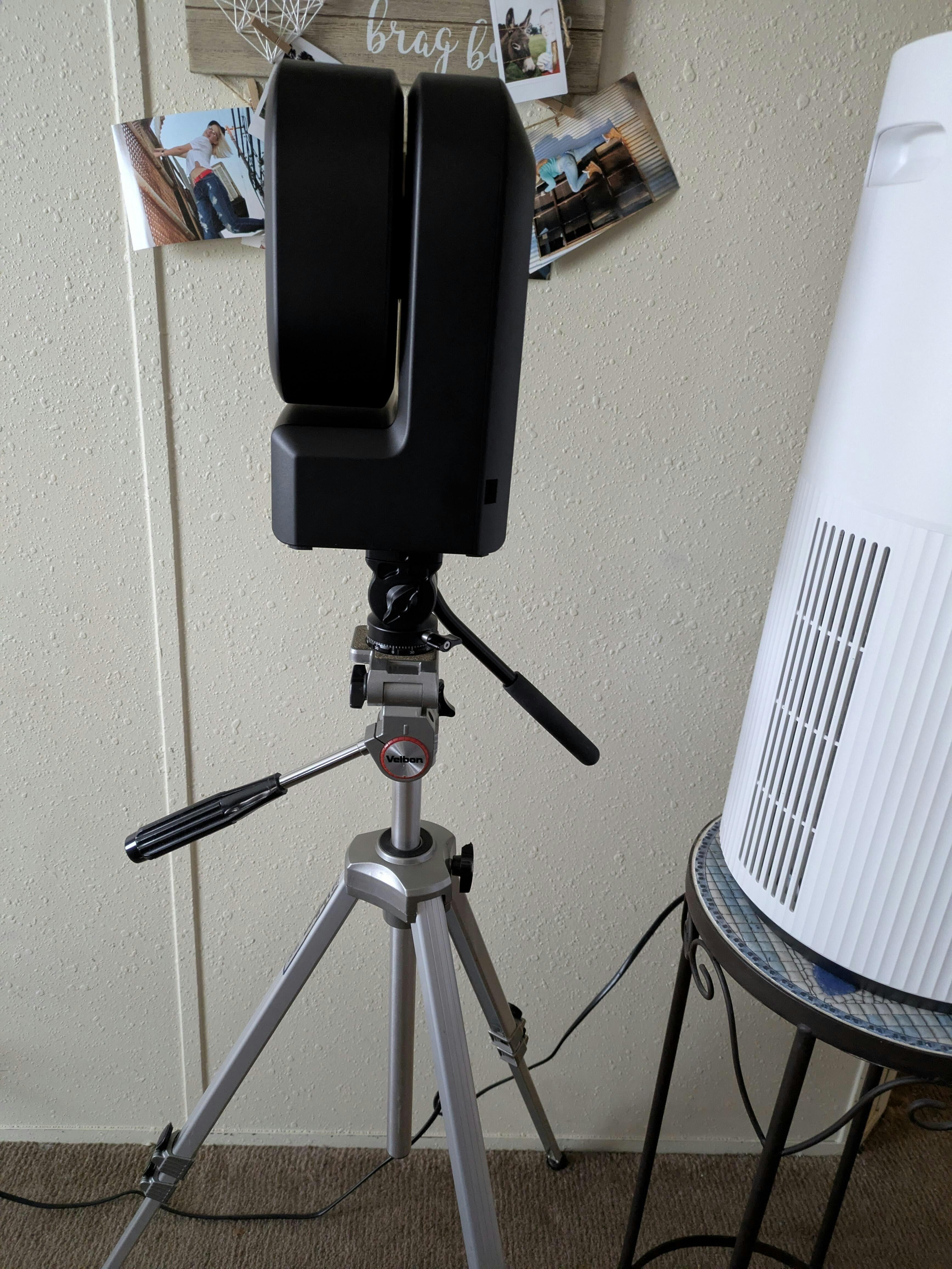

A really nice product that's well built, easy to use and great for using my Seestar S50.

The Seestar TH10 tripod head work 100% better than my photographic tripod head!
