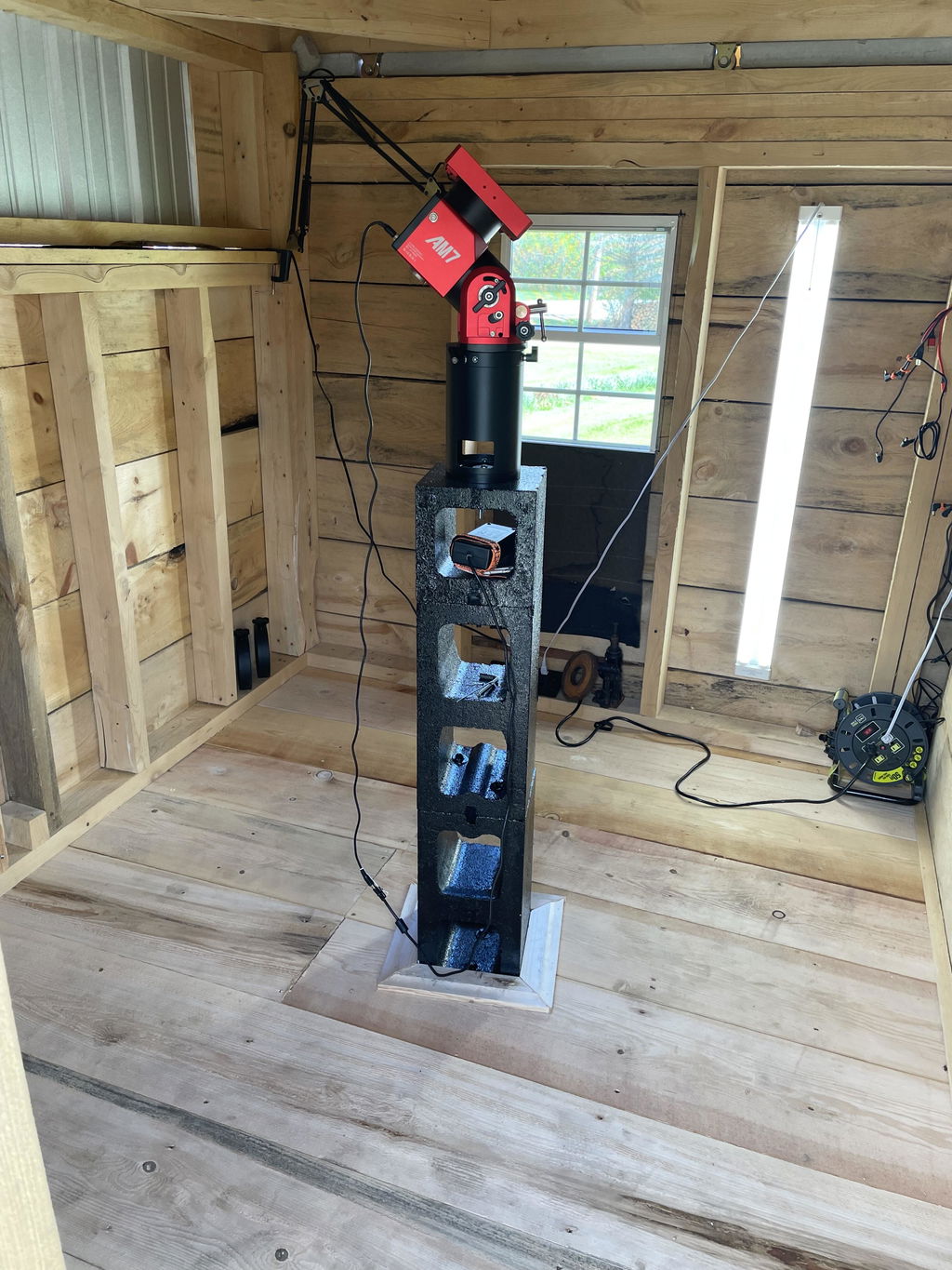

Mark E Weeks
So far very impressive. Best guiding numbers I’ve ever had running my C11 533 mc pro with all the goodies. Blue tooth works flawlessly. I couldn’t be happier.
Mark E Weeks review photo Mark E Weeks review photo Mark E Weeks review photo

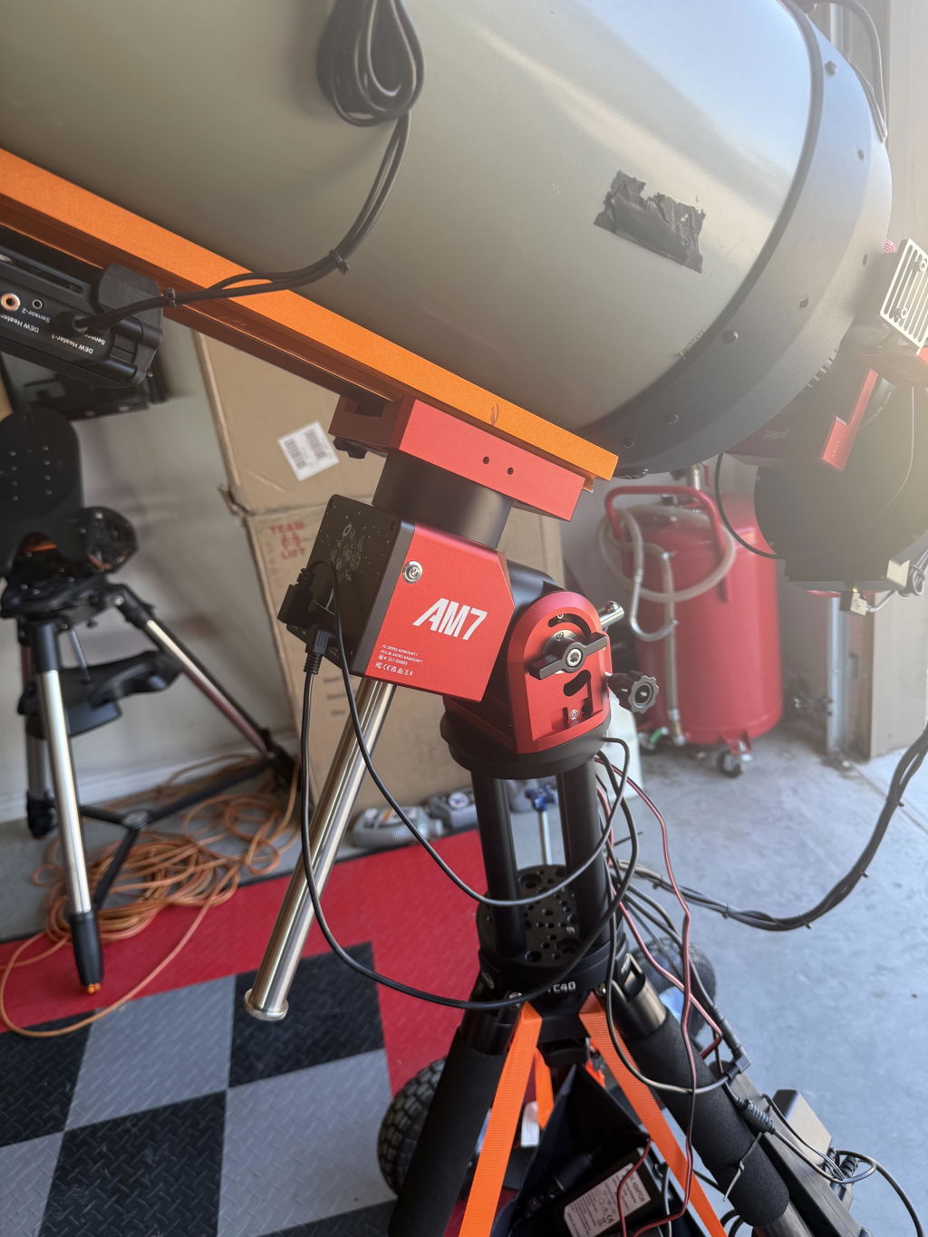

Danny Allen
Have a C11 with every known accessory. It overloaded the AM5. The AM7 handles it with ease! Loving it.
