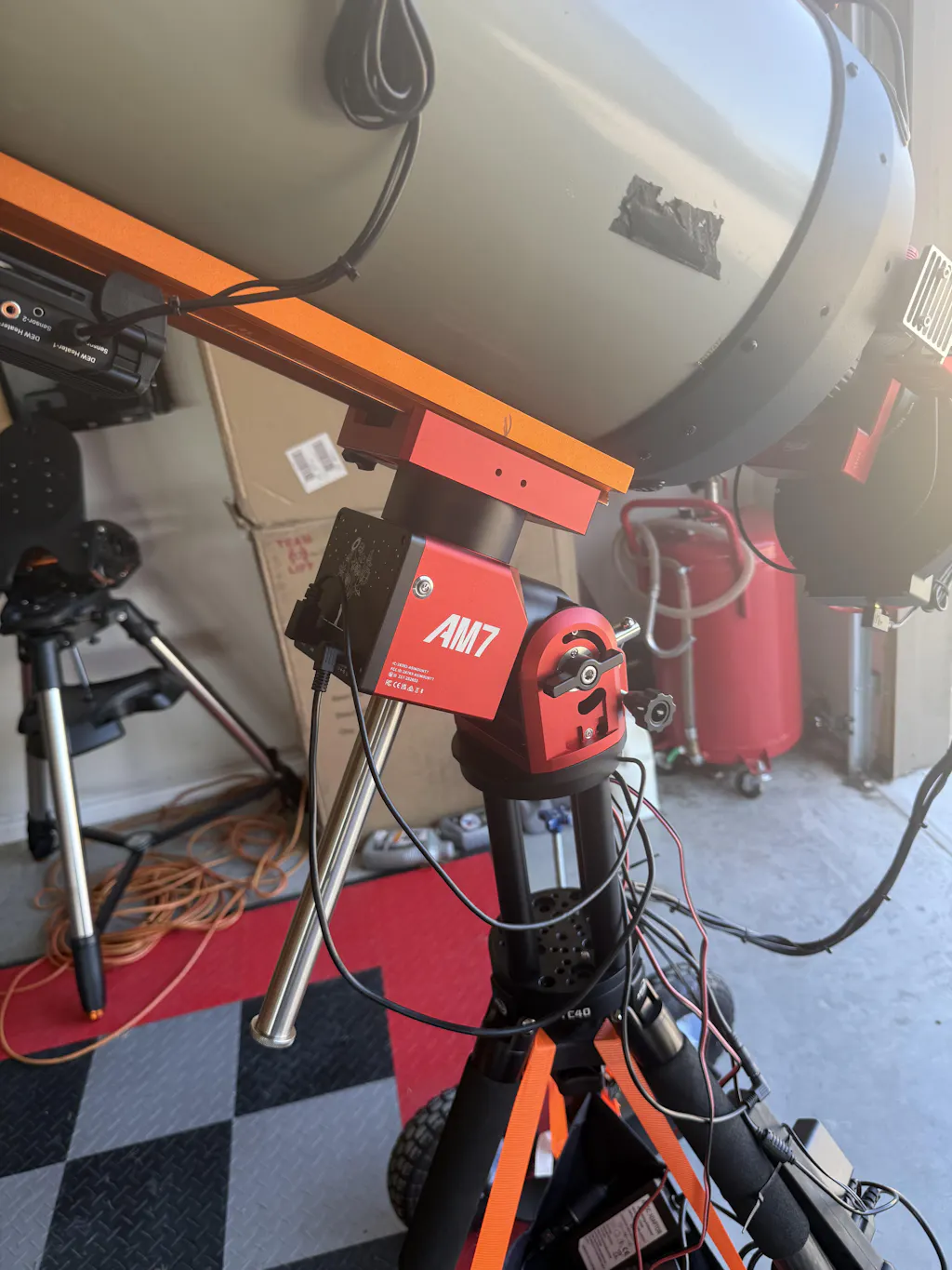

Have a C11 with every known accessory. It overloaded the AM5. The AM7 handles it with ease! Loving it.
