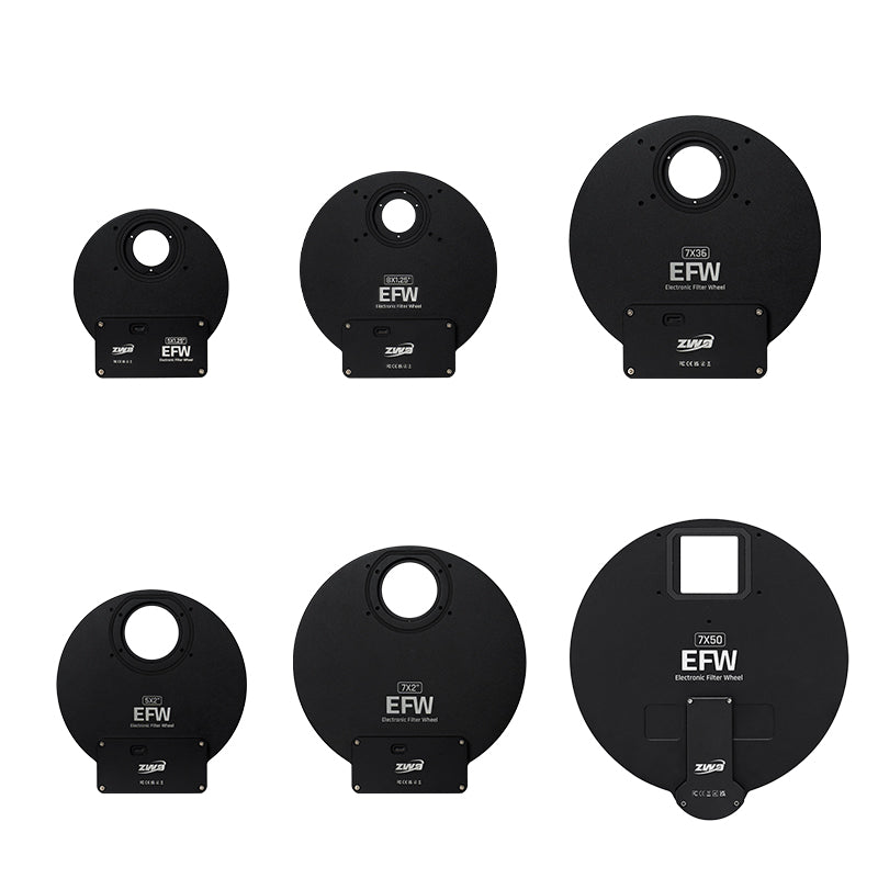

The ZWO Electronic Filter Wheel (EFW) is available in four models, supporting the following filter sizes:
  Ø1.25"/31 mm filters
  Ø36 mm filters
  Ø2" filters
  Ø50 mm square filters
Key Specifications
Category Filter Wheel Slots Effective Thickness Supported Filters Weight
EFW (Ø1.25")/31mm 8 Slots 20mm 1.25" mounted filters,
filter area thickness ≤ 7 mm
Ø31 mm unmounted filters,
thickness 1.5–3.5 mm
530g
EFW (Ø1.25")/31mm 5 Slots (EFW Mini) 20mm 1.25" mounted filters,
300g
EFW (Ø2") 7 Slots 20mm 2" mounted filters,
Ø50 mm unmounted filters,
720g
EFW (Ø2") 5 Slots 20mm 2" mounted filters,
540g
EFW (Ø36mm) 7 Slots 20mm Ø36 mm unmounted filters,
thickness 1.9–3.5 mm
515g
EFW (50mm Square) 7 Slots 16mm 50×50×3 mm filters
(supported thickness range: 3–4 mm)
886g
Compatibility
Engineered for full compatibility with all ZWO filters for dependable image quality.

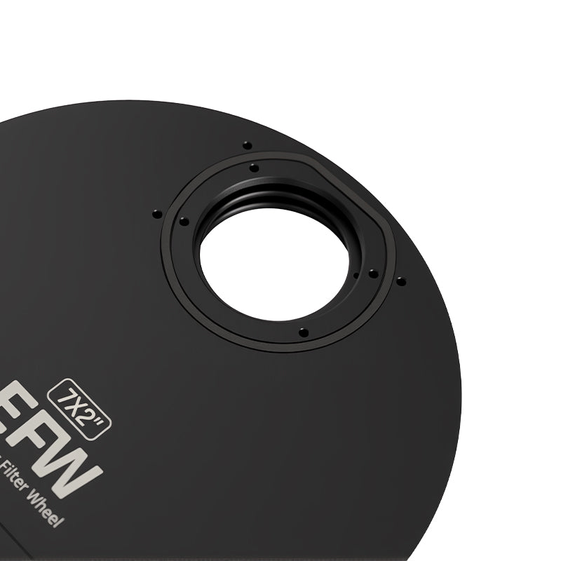

For mounted filters, ZWO recommends using standard mounted filters with a 2.5 mm cell thickness. When using third-party mounted filters, if the filter cell outer diameter exceeds the filter wheel counterbore size, only filter cells thicker than 1.5 mm are supported.

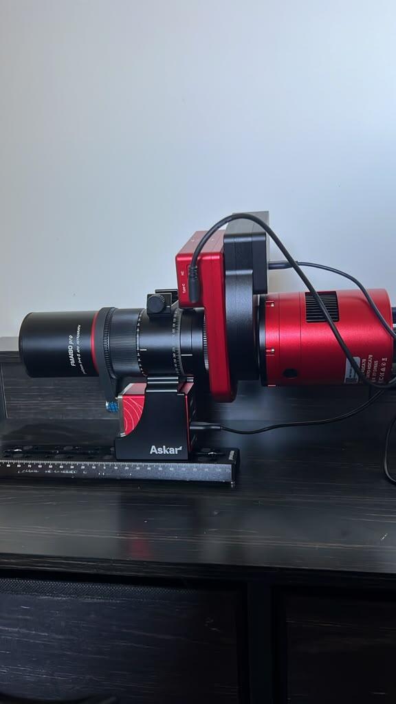

R
Rimas Stropus
EFW so far is working great. Nice and quiet and rotates without any conflict. Only issue I have is the documentation. I have mostly ZWO back end and it’s not an unorthodox set up and lacked the detailing for reducer/Spacer/CCA/EFW/Camera explanation. Particularly, how to mount my 2600 Duo! It wasn’t in the procedure!!! I mounted the EFW using the supplied screws working from inside the EFW to secure the camera. Lots of confusing and misleading information out there even from ZWO regarding this. It was 100% unclear how to do it!
