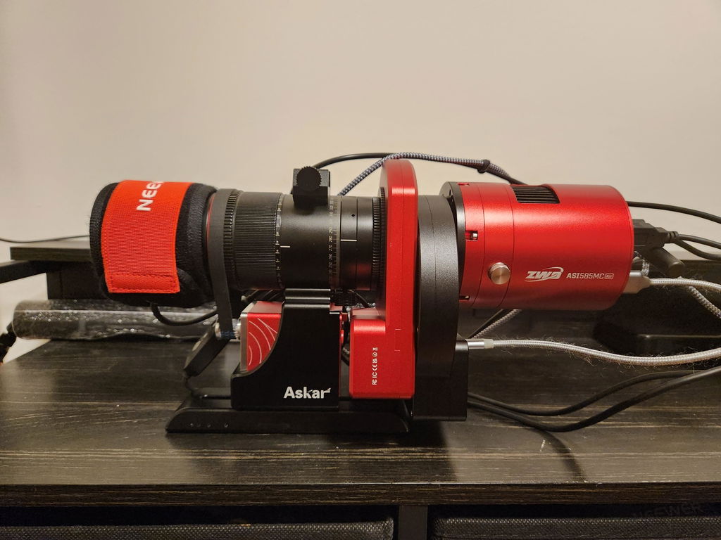

Perfect for use with the Askar FMA180PRO with the EAF kit. I am using a CAA, EFW with my ASI585MC AIR camera and the usb c wires on the previous EAF was restricting me from keep the CAA aligned with the base plate, however with the EAF PRO with bluetooth I can clearly ditch the cable and connect wireless with the ASI585MC AIR.
