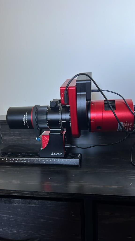

Excellent to manage the framing. I have paired it with the ZWO eco system with ASI585MC AIR, EFW and EAF on FMA180PRO. The results are impressive and the ease of control is very good when it comes to framing. The CAA motor is very smooth and produces very low noise. I just wish it also came with Bluetooth pairing and inbuilt battery like the EAF so that it can connect wireless to the ASIAIR and there is no need to worry about dangling cables which might get caught when the filter wheel rotates with the camera.
Raghuraman R review photo
