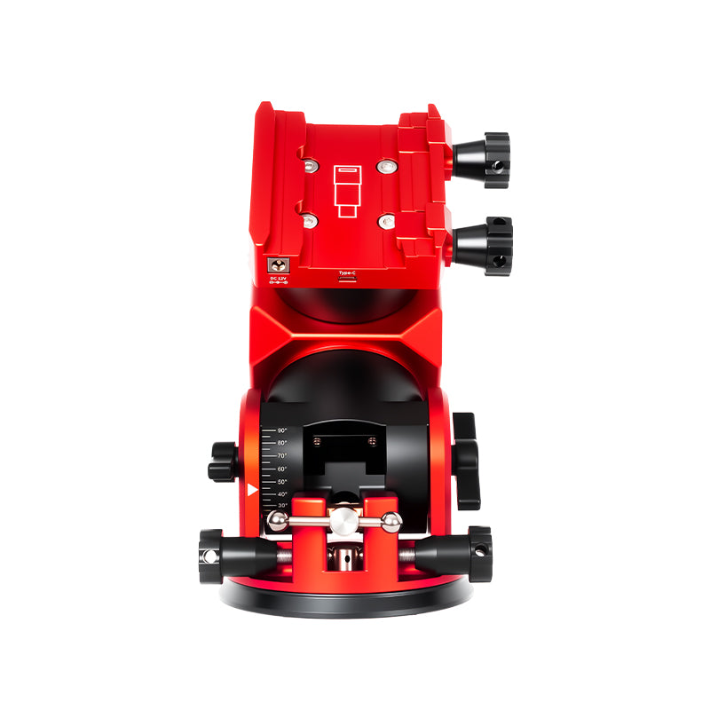

All-round 0°-90° Altitude Scale
The AM3N features a versatile altitude adjustment design ranging from 0° to 90°, allowing for unrestricted use across both low-and high-latitude regions.
Gear 1: Rotate the altitude tension knob for adjustment between 0 and 60.
Gear 2: Loosen the M6 hex screw, and allows adjustment from 30 and 90.
