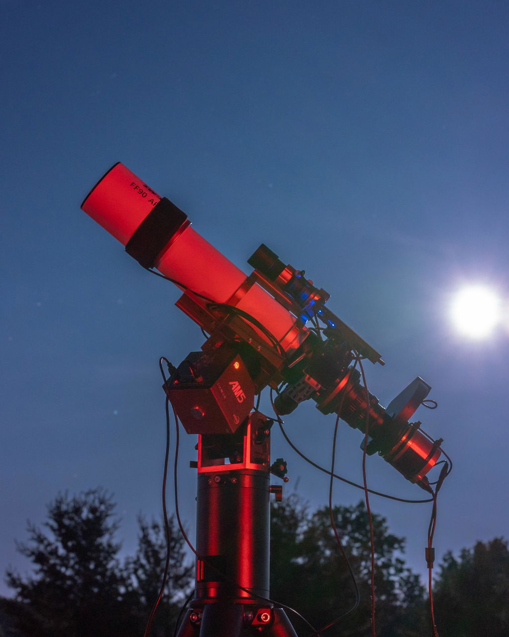

Willie Stickley @WillieHustles
An excellent performer at the price; I was blown away by the resolving ability of this scope and the superbly corrected stars (I tested out to APS-C). The fine focus knob is a dream to use and the highest praise I can give this: It just works, and works well!
Willie Stickley @WillieHustles review photo Willie Stickley @WillieHustles review photo Willie Stickley @WillieHustles review photo Willie Stickley @WillieHustles review photo
