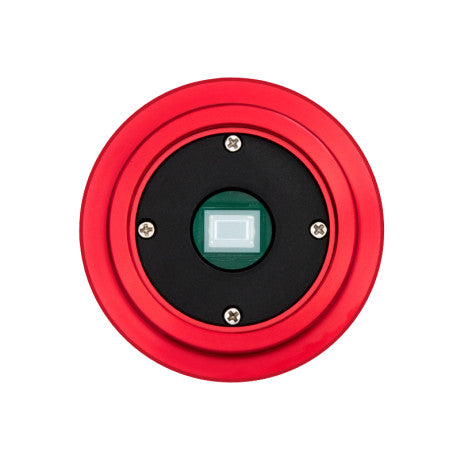

The ASI662MC/MM is equipped with the Sony-IMX662 rolling shutter CMOS. Boasting a 1/2.8" frame size combined with a 2.9μm pixel size, it features 2.07 million pixels (1920×1080), and possesses both high sensitivity and low read noise characteristics. In high-speed mode, it can output 107.6 frames per second, providing reliable support for planetary observation.

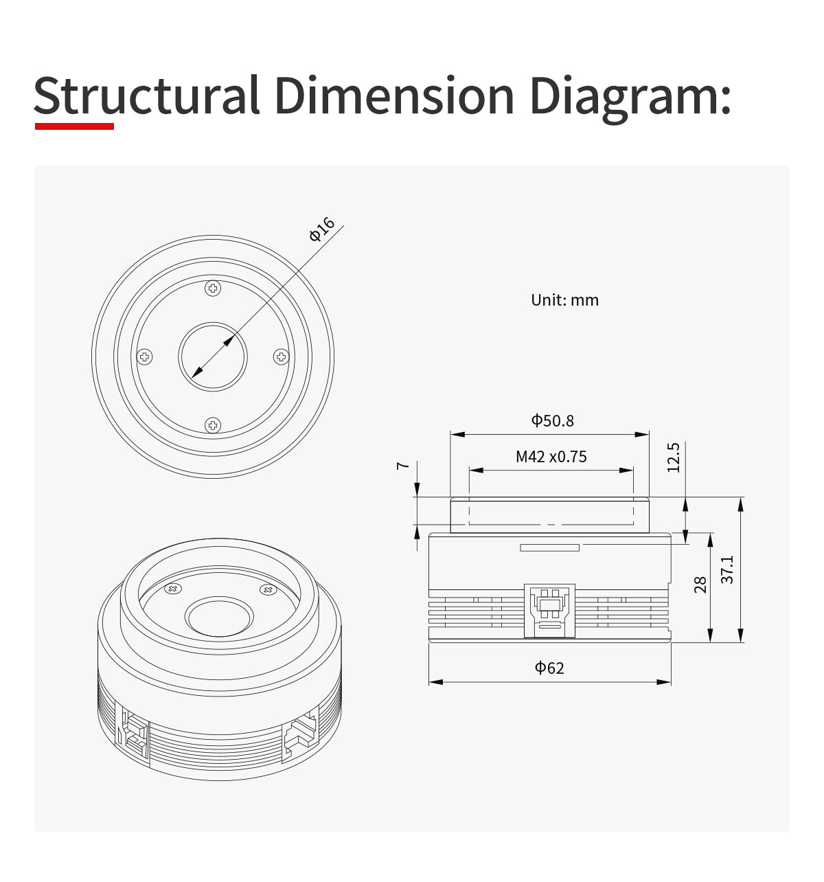

Mechanical Specifications
Mechanical Diagram
