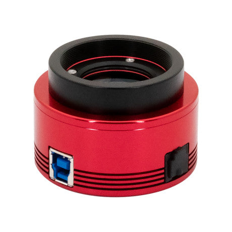

ASI183MM
ASI183MM monochrome camera

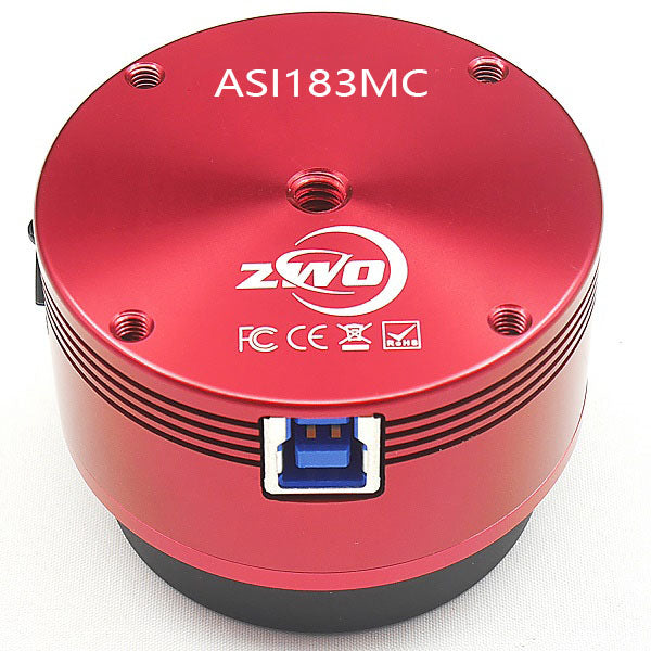

ASI183MC
ASI183MC color camera
USB 3.0 Port & ST4 Port
USB 3.0 Port: Provides 5Gb bandwidth to enable ASI183 to run at 19 fps (12bit, normal mode) or 19 fps (10bit, high speed mode) at full resolution (20.18Mega).
ST4 Port: Can be used to connect with auto guide port of mount for guiding.

ASI183MM
ASI183MM camera

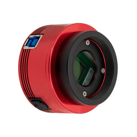

ASI183MC
ASI183MC camera
