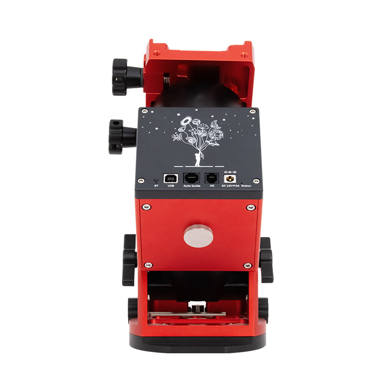

*Note: The recommended operating voltage for the ZWO Harmonic Equatorial Mount is 12V. When the actual input voltage is below 10.8V, the mount will emit a beeping alarm to indicate under-voltage condition. To ensure proper functioning of the equipment, we recommend using the official ZWO power adapter and an appropriately sized power cable.
