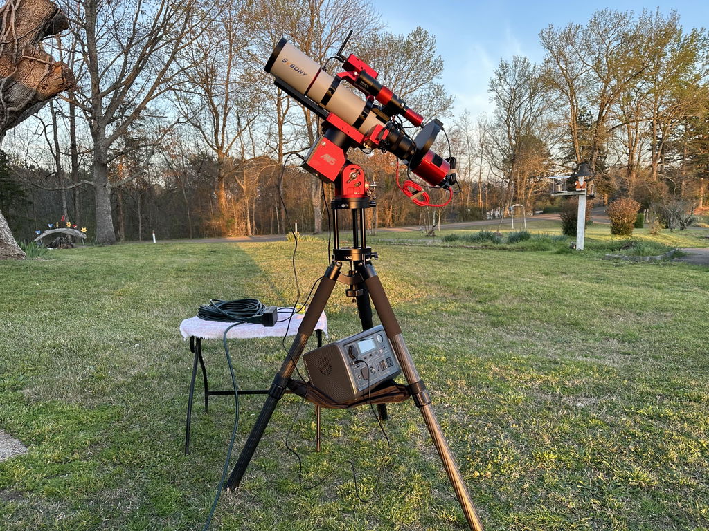

One of the best mounts you should buy without a doubt. The guiding is so good at under .60 arc seconds that I can keep every exposure I take. Also the light weight design of the mount with the carbon fiber tripod makes setting up so much easier. Slewing to targets is very fast, precise, and quiet. One last thing to note is buy it! You won’t be disappointed.

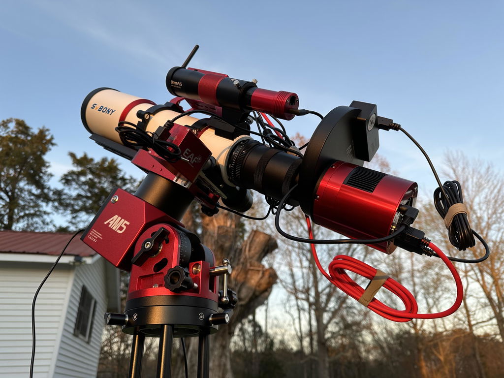

Did my first imaging session last night using the AM5N with the ASIAIR Plus and it was fantastic!!
