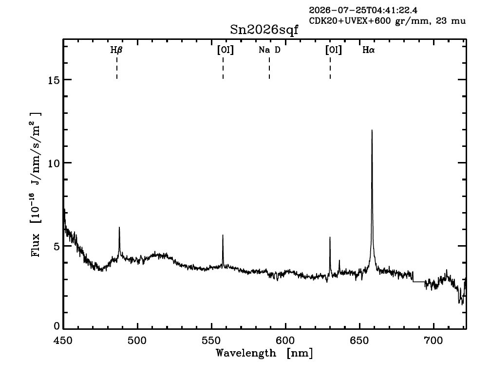

I have used six different cooled, CMOS cameras. The ASI294 gives large area for a low price. The "telegraph noise" is modest. It gives good performance for a modest price.
Geoffrey Marcy review photo
