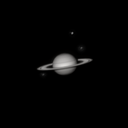

We are entering the Saturn and Jupiter season, so I am very excited to start again with these targets. I already had my first Saturn capture for this season at summer solstice.
