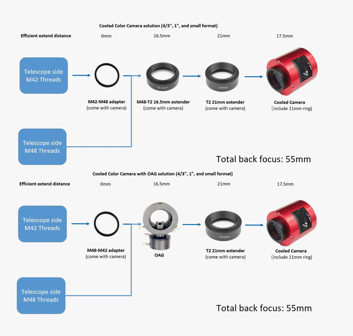

ASI183MC Pro (color)
1. M43-T2 adapter
2. EOS-T2 adapter
3. 2”Filter (optional)
4. 1.25” T-Mount
5. 1.25” Filter (optional)
6. M42-1.25” adapter (optional)
7. T2 extender 11mm
Mechanical Diagram
Spacer thickness: 0.1mm *1+0.2mm *2+0.5mm *1
The best solution of 55mm back focus length
ASI183MM Pro (mono)
Read more: The best solution of 55mm back focal length
