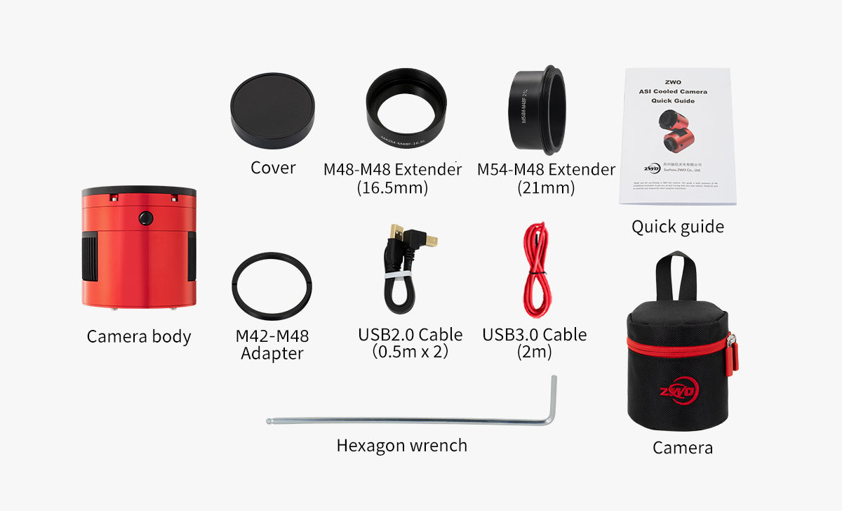

Mechanical Diagram
The best solution of 55mm back focus length
We know that connecting new equipment can be daunting at first, so to help you out we have made a tutorial on detailed connection methods of ASI6200. So if you want more details than the above images, just click the link below:
