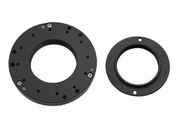

The New T2 tilter adds multiple screw holes to help connect to ZWO EFW (compatible to 2” EFW filter wheel).
Package and size
Main body:Diameter 78mm,11mm without the T2-T2 adapter
T2-T2 adapter:Thickness 2mm
Interface: T2 (M42*0.75 thread) each side
Product usage
- Mainly used to reduce newton ring when imaging ha-solar;
- Also used to adjust the camera imaging plane by rotating the six bolts in the main camera body when the sensor plane is uneven.
Applicable cameras
All ASI cameras except ASI071, ASI2600 and ASI6200.
Connection method
1. Cooled camera: ASI294/ASI1600/ASI183/ASI533
2. Non-cooled camera:
ASI294/ASI1600/ASI183/ASI174
These cameras do not need to connect to the T2-T2 adapter
ASI178/ASI290/ASI224/ASI120
These cameras need to connect to the T2-T2 adapter first.
Mechanical drawing
What’s in the box?
T2 tilter *1
T2-T2 adapter *1
Hexagon wrench *1
Screw*6
