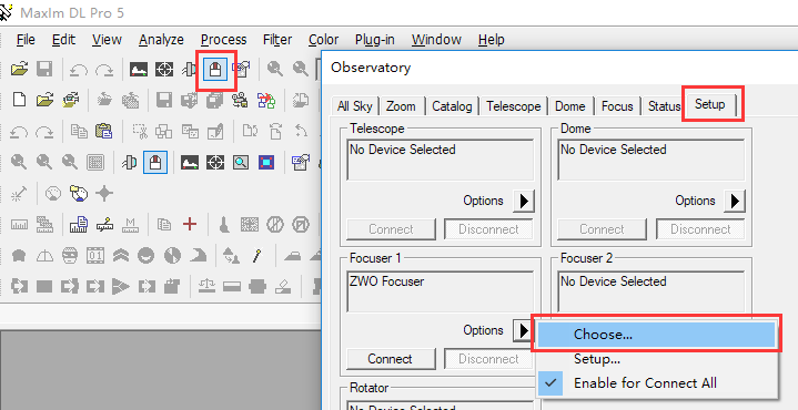

Maxim DL Pro
1. Open “Observatory panel”, in “Focuser 1” option, click “Choose…”. MaximDLPro_EAF_setting-12. Choose ZWO Focuser in ASCOM panel. MaximDLPro_EAF_setting-2
