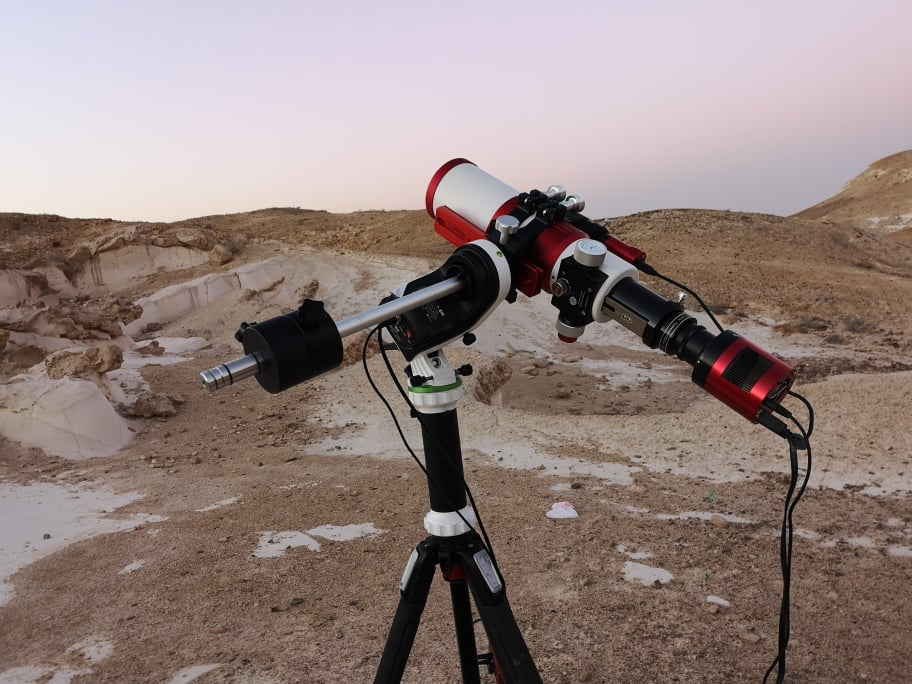

My equipment setups are as follows:
Milky way astrophotography - iOptron Sky Guider Pro + William Optics Red Cat 51 + ASIAIR PRO + ASI071MC Pro + ASI120MM Mini.
This setup serves well for travel and hiking to locations.
