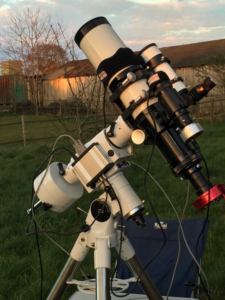

My primary setup includes a Celestron RASA 8 on an iOptron CEM40 mount. I image with an ASI1600MM Pro connected to an ASIAIR Plus and a ZWO EAF. I have a 60mm Orion guidescope and an ASI290MM Mini guide camera. I generally shoot narrowband as I am in Bortle 9 skies most of the time, and my go-to filters are 2” Baader 3.5/4nm f/2 filters.
Gear
