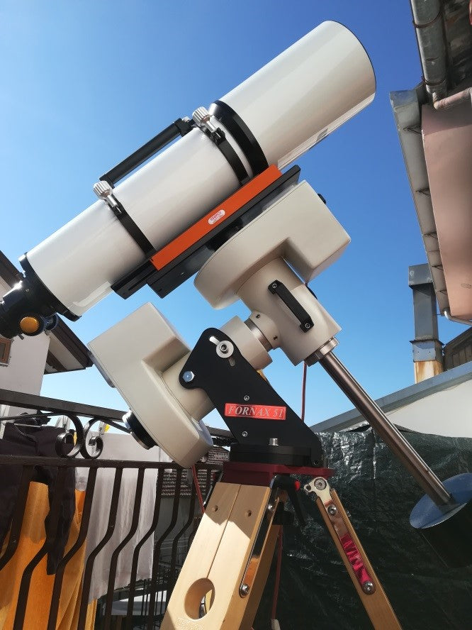

I like to sweep in the different fields of astrophotography: from the planets, to the Sun, to the Moon, to the deep-sky images. During these years I try to optimize my setup for the different kind of work. From last year for Hires Planet imaging I used a Celestron C14 Edge HD on a Fornax 52 mount. Recently I have acquired an Hyperstar system for my C14 and I have very fast system f/1.9 and with ASI1600MM Pro, I use it for deep-sky imaging and for Asteroidal occultation.
I have also a TS152/900 with a Daystar Quark Cromosphere filter 0.5A that I use is for H-alpha solar imaging. I have also a newton 250mm f/4 for visual observation.
