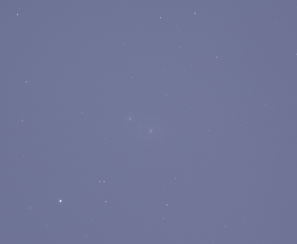

My father owns a twenty-year-old Vixen rig consisting of a computerized GP-DX mount with SkySensor2K and an 8” Newtonian (R200SS). Back in February 2021, initially planned as a one-off event, I used my unmodified Nikon D3200 with a simple T-ring adapter on the R200SS and shot M42, the Orion Nebula. Due to the horizon-limited location at the time, I was only able to shoot for about ten minutes. Before packing up, we slewed to M51 and I was exposed for 60 seconds just for fun. In the small preview on the camera display, I did not see the galaxy at first glance which is why decided to not further follow up and pack up for the night. When checking the image on the PC later that night, against any expectations, I saw faint structures M51.
That was the exact moment, my astrophotography journey started. From there, it quickly became apparent that investments are necessary to achieve better results. I plunged down the rabbit hole.
