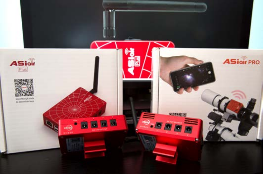

ASIAIR Plus and ASIAIR PRO side by side

The next thing I was really pleased with, (once we did get outside due to some nicer weather) was that the Plus has the addition of an external Dual Band (2.4Ghz/5Ghz) WiFi antenna, which gives ASIAIR Mounted to WO GT 71 Scope ASIAIR Plus and ASIAIR PRO side by side the WiFi much better range than the PRO unit. This saw an overall better speed connection on my home WiFi 2.4Ghz network. The download times for images from the device to the iPad were better. ZWO advise the range is now up to 20 meters, but at this stage, I am well inside that and have not had any connection issues. Overall this is a big improvement on the PRO.
What also helps with download times is that the Plus now has eMMC at its heart. For those that are into the tech specs, the term eMMC is short for “embedded Multi-Media Card” and refers to a package consisting of both flash memory and a flash memory controller integrated on the same silicon die. For the rest of us, this means the software that controls the Plus and the media storage device, is integrated into the one chip. This is a 32Gb eMMC chip which after the OS of the Plus leaves approximately 20GB of storage for your images. This eliminates the need for both a USB stick for storage of images and Micro SD card for the operating system, as is the case with the PRO. Another big advantage over the PRO is you no longer have any issues with needing to backup the SD card for the system as the Plus has a Reset Firmware and Auto Recovery capability. Hence the new small Reset button underneath on one the end of the Plus. (See image at right) Not to mention 85Mb/s read speed and 52Mb/s Write speed.
