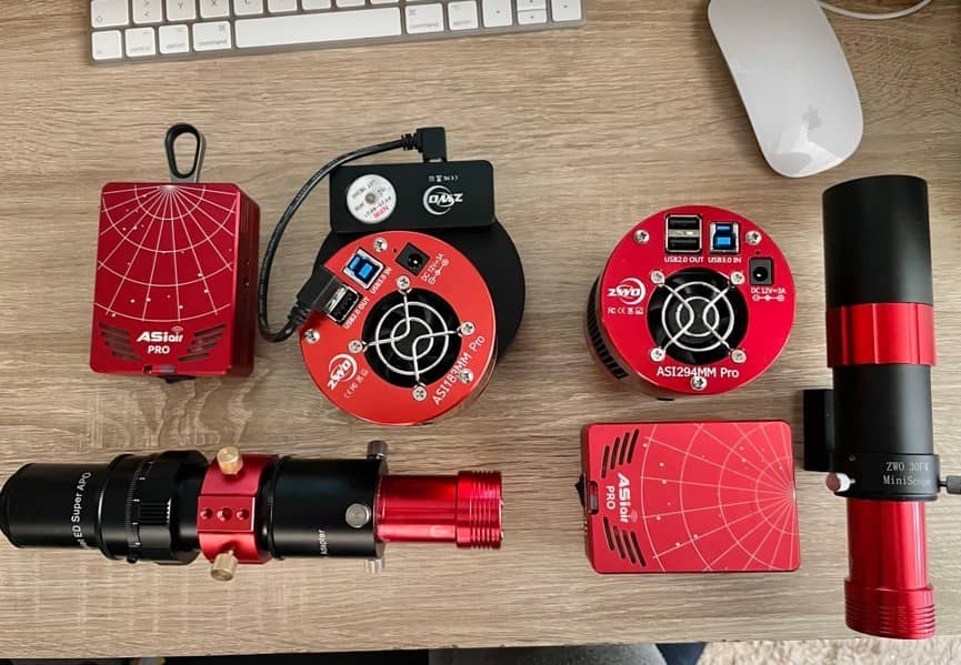

    These are my imaging rigs, the ASI294mm pro and the ASI2600MC pro. I used to own ASI183MM pro which is also a fantastic camera. I used the ASI2600MC pro to photograph the Barnard 150.
    I have two refractor telescopes, the Askar fra400 and Ts optics 106/700 FCD100 triplet, each mounted on Ioptron Hem27 and CEM40.
