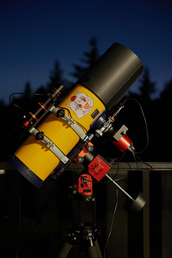

And we are now ready to dive deep into the technical factors which affect the guiding accuracy and the shape of the stars. I will also provide methods to quickly cross check whether each factor is the cause, and how to fix it if it’s the case. 图片1
Figure 2. ZWO AM5 EQ mount on a TC40 tripod and a 2nd gen half pier, showing one of the testing gears in this review.
Tripod and Polar Alignment
An often overlooked factor in the mount system is the tripod. The major impact of the tripod is the polar alignment when the scope points to different directions, which is caused by the subtle deform of the tripod. The popular carbon fiber tripods are indeed stiff and solid. We often see demos of an adult standing on top of it. But on one hand, astrophotography has much higher requirements on precision, to the arc minute level, than regular photography. And on the other hand, the unique property that strain wave mounts don’t require balancing gives extra challenges on the tripod. The lack of counterweights and balance means the center of gravity is no longer always kept above the center of the tripod. Instead, it will shift around when the scope moves. This brings a new type of deform and thus requires new tests to the tripod. 图片2
Figure 3. A TC40 tripod with steel feet
The test of tripods is relatively easy. When we use tools like ASIAir or SharpCap Pro to do polar alignment, it will show a alignment error after the RA axis rotates. We could start from the home position (pointing to the Polaris, right above the tripod), turn the RA axis 90 degrees to the west to do the polar alignment, and take notes of the remaining alignment error. After that, we start from the home position again, but turn the RA axis 90 degrees to the east to check the alignment error. (For ASIAir, because we can only rotate the RA axis to the west, we can start from the east-most position, and rotate 90 degrees to the home position) When the tripod is an ideal rigid body, we should observe the same alignment error both sides. And when the tripod has deformation, the alignment error would be different. My testing shows that if we mount a SharpStar 13028HNT without a counterweight, RT90C shows 8 arc minutes’ difference in alignment error, and TC40 shows only 2 arc minutes. Note using counterweights would impact this difference as well. The better balance one gets, the less movement the center of gravity there is. And this will reduce the polar alignment shift. Furthermore, not only the carbon fiber tubes could deform, the feet could also deform. I found the rubber feet of RT90C pretty soft. I could introduce decent deformation by hands. TC40 has harder feet but still not ideal. It’s said that steel feet like those from SuperMount could bring quite some improvement, but it also comes with a premium. If one really gets error in polar alignment, the result would be field rotation. Field rotation cannot be removed by guiding. Because the movement can be decomposed into two parts, a global translation, which could be corrected by guiding, and a rotational movement surrounding the center of the field of view. This part can only be corrected by rotating the camera, and goes beyond the capabilities of the guiding system. In this case, one may get a decent guiding error but still have trailing stars, especially on long exposures, which is the indicator of a polar alignment issue.
