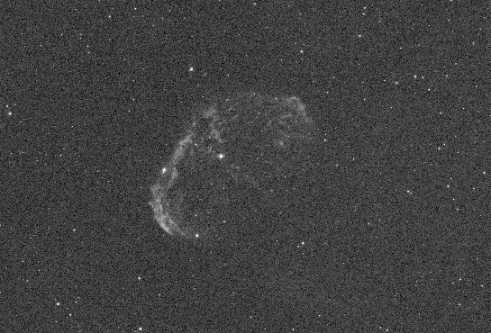

ASIStudio v1.7 First, download ASIStudio if you still haven’t had this software on your computer. Install it and then launch ASIFitsView. ASIFitsView_open_a_fits_file Find a light file and then open it. Open_a_file Click the second icon from the right at the bottom of the ASIFitsView interface. The number 1 shown in the center of the icon represents BIN1. BIN1 Click this icon to turn BIN1 mode to BIN2 mode. BIN2 Click it one more time to turn BIN2 mode into BIN4 mode. BIN4 See? You can switch between different BIN modes as easy as 123. How about the actual results of the images at BIN1, BIN2 and BIN4 modes? We may take the NGC6888 (as known as Crescent Nebula) image captured with ASI294MM Pro as an example.
Crescent Nebula BIN1 ModeAt BIN1 Mode
Crescent Nebula BIN2 ModeAt BIN2 Mode
Crescent Nebula BIN4 ModeAt BIN4 Mode
You can see clearly the signal-to-noise ratio improved in the single images. Compared to the image at BIN1 mode, the Crescent Nebula at BIN4 mode looks much brighter with much more details, at the sacrifice of a 16 times lower resolution. Is this sacrifice acceptable for you to pay? Let us know by sharing your thoughts in the comments!
