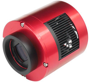

ASI294MC Pro is the first camera in the world that equip with SONY latest sensor IMX294CJK.

ASI294MC Pro has same mechanics as ASI1600 Pro. There are 4 screws seal the chamber. This structure has been fully tested and it is very stable. Even with high humidity eviroment, ASI294MC Pro will still works fine without dew problems. ASI1600v3_600X600NEW
