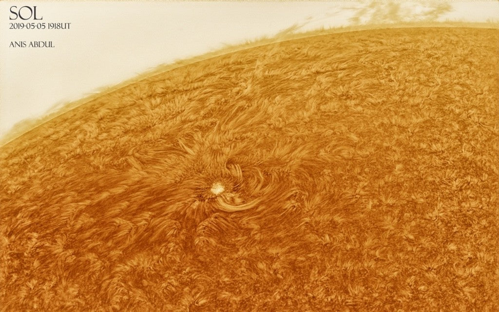

4. Solar:
Astrophysics AP900GTO mount with Explore Scientific AR150 Doublet or Orion ST80 with Daystar Quark Chromosphere and ZWO ASI174MM.

solar
Sun in HA using Daystar Quark Chromosphere, ES150 Doublet, ASI174MM

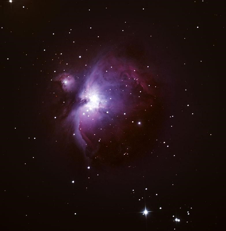

It all started in 2014 when my wife gifted me a 6’’ Newtonian telescope and I stuck my DSLR with T-mount adapter into the focuser. Like many, once I saw the image of Orion Nebula, I was hooked! The biggest contribution in developing the craft came from the fine folks at the Beginning and Intermediate Imaging forum at CloudyNights. There are lot of very helpful members who went out of their way to help new imagers like me. For that, I am forever grateful. I also had a lot of help, specifically in Pixinsight from local members in Austin. It took about 6 months before I got a reasonable image (M51) using DSLR. Within one year, I had bought a SBIG ST-8XME and then a QSI683 and I was completely consumed by the hobby and it is still going string!
Here is my very first image:
9
My first astro image in Jan 2014 – Celestron OMNI150 XLT with Canon T3 DSLR!
