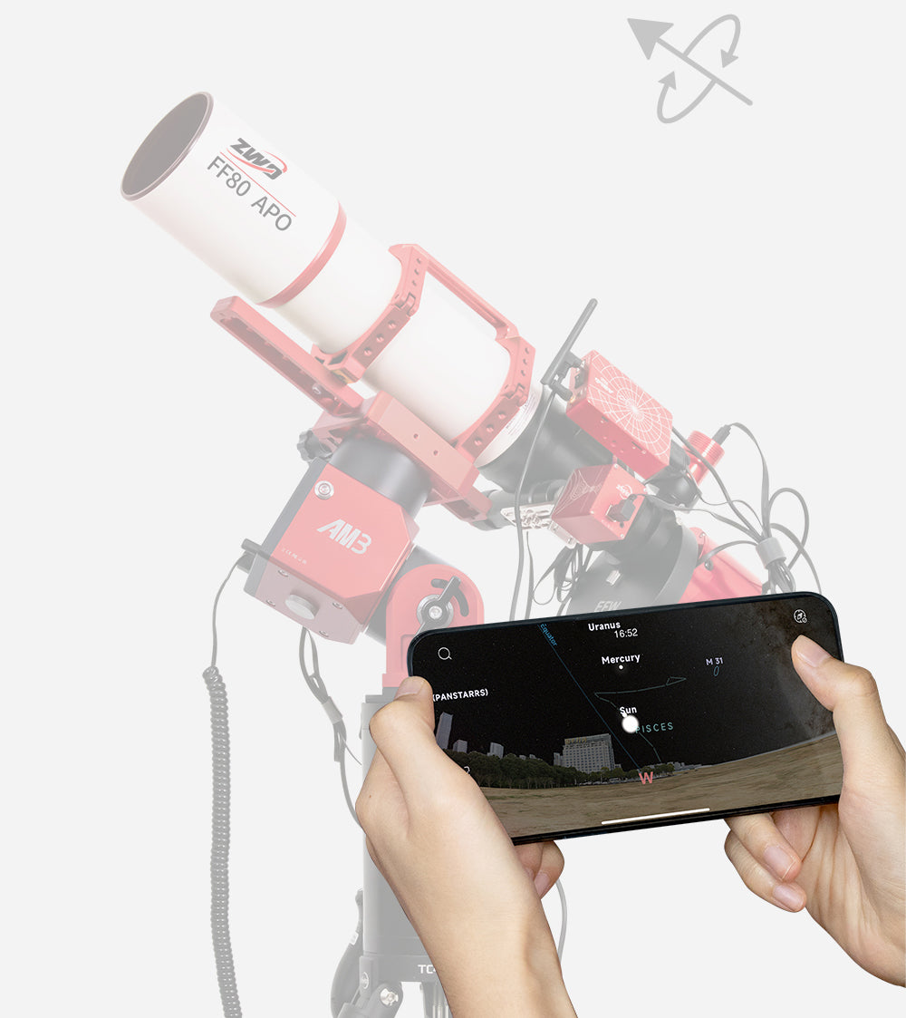

Wireless Control
Tonight’s Target, GOTO, Live Preview and so many great functions can all be achieved with your phones.
