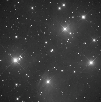

M45 as the first target, shot at 5 minutes each frame, 1 hour’s shooting in total. When the image came out and kept as original without debayer, I was already shocked!
ASI533-shootintg-1
The shooting software showed as below at that time:
ASI533-shootintg-2
5-minute single picture. Here's what it looks like in PixInsight after doing only debayer and stretch. The blue stars and clouds of the M45 Pleiades are already very clear.
Besides, " Microlens Diffraction Effect " of bright stars like Pleiadess on chips such as IMX183 did not appear during a 5-minute exposure.
